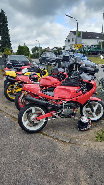

Merry Xmas from Germany!
Here is my Saturno,
the Nordwest is not finished yet. The starter is to weak to start the engine. When I exchanged the starter it fired up right away. - So I will follow your recommendations and clean it first and exchange the cables. Are there any source for new coals known?
Happy holidays!
Carsten

Merry Christmas to you too, Keep already in what state yours are, then we’ll see how to find something. It’s Nippon Denso, it’s got to find it.
Looking at the photo I see that you removed the filter box mounted a radial Master cylinder and an oil radiator, did you make any other changes?
And I see her as well surrounded 2 Saturno a Ducati NW and further a Volvo 544 she to a friend of yours?

Dear Franck,
thank you for ll the details. The Volvo 544 belongs to a the Gilera/Ducati dealer who’s hobby is Volvo.
The photo is from a joint gathering of Saturno and Volvo drivers. - In the evening he performed in his other hobby: rock music live!
To my Saturno: It has the Nordwest valves, 100mm piston and other cams. Flywheel is lighter.
The fork is optimized by an expert and the rear damper is from Wilbers suspension.
I placed a light lithium battery in the rear.
I think that’s it.
With Pirelli Diabolo Rosso III perfect for me.

581 ccm.

Belle préparation, sur ma Saturno j'ai dû changer le moteur, remplacé par un NW, monté avec la culasse de Saturno standard, je l'ai monté avec un CDI de RC 600, carburation légèrement modifié., amortisseur Olhïns, maitre cylindre Radial PR 19 Brembo à l'avant, Bridgestonne S20, ça va bien aussi.
Nice preparation, on my Saturno I had to change the engine, replaced by a NW, mounted with the standard Saturno cylinder head, I mounted it with a CDI of RC 600, carburation slightly modified. , Olhïns damper, Radial PR 19 Brembo master cylinder in front, Bridgestonne S20, it’s fine too.

Hi Franck,
your modifications are probably ver similar to mine but a lot cheaper. I did not mention the Mikuni carburator on my list.
Today I would do it probably your way.
